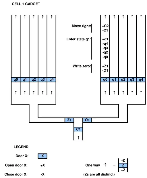

Perhaps you can easily simulate a LBA; the idea is the following:
  • for every cell of the LBA tape add a cell gadget $G_i$ that can be entered only from the bottom and leaved only from the top;
  • the gadget has an entrance door $C_i$ which simulates the head position (only one $C_i$ is opened at every step);
  • then there are two bit doors $Z_i$ and $O_i$; $Z_i$ is opened if the cell contains a zero, $O_i$ is opened if there cell contains a one;
  • both bit doors lead to a similar control structure which is made by several one-way corridors; a corridor corresponds to a state of the LBA, and the door $q_i$ of the $i$-th corridor is opened if and only if the current state of the LBA is $q_i$;
  • according to the (possibly non-deterministic) transition table of the LBA, a traversal of the (opened) corridor changes the current state of the LBA and the configuration of the bit-doors, closes door $C_i$ and opens $C_{i+1}$ or $C_{i-1}$.
A cell gadget is sketched in the figure below.

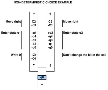

Non-deterministic choices can be realized splitting the corridors in the control structures into two or more sub-corridors as shown in the figure below.
Note: if a plate can only open/close a single door, then you can add an auxiliary structure with (long) one way corridors that (de)activates the distinct state doors of each cell.

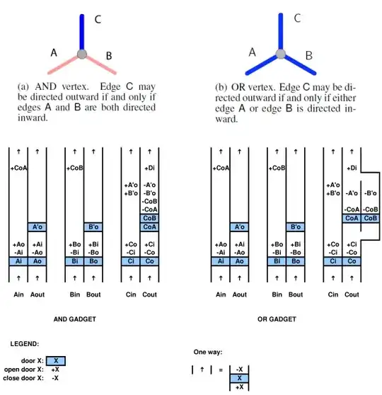

Another quick way to prove the Metatheorem 2c (PSPACE-hardness when the doors are controlled by two plates) is to use the Nondeterministic Constraint Logic framework (R.A. Hearn and E.D. Demaine, The Nondeterministic Constraint Logic Model of Computation: Reductions and Applications).
In this case it is sufficient to use an horizontal series of vertical corridors-pairs. The state of each pair of corridors represents the direction (inward/outward) of an edge in the original constraint graph. It is sufficient to simulate the AND gadget and OR gadget, like sketched in the figure below.
Marzio De Biasi
