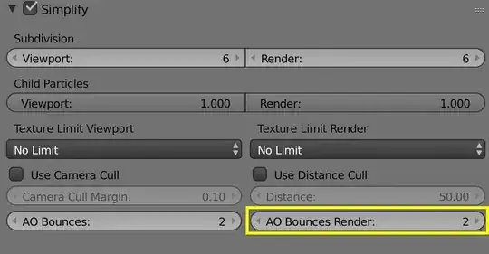

I recently discovered that turning on Simplify in the Scene panel, and setting "AO Bounces" to 2, reduced my render times from 30 minutes to 10 minutes. A three times speed improvement! But... I still don't know what it actually does, and there appears to be no documentation for it.
AO bounces value in scene panel

Besides looking darker, there's not much noticeable difference.
Someone on twitter told me that it limits the light bounces in the scene to the value you set, then uses AO (with color set to the world color) in it's place.
But I'm confused by this, because 1. AO isn't even turned on 2. I changed the AO dist from 1 to 6 and it made no difference
But yes, it is using the world color somewhere (set to black in the above example) because I did a test setting it to purple, and the scene looked purple.
So does anyone know what it actually does?

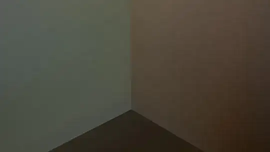

Here is a simple setup to demonstrate - camera inside a cube (10 BU * 10 BU), only light source is an HDRI on the world:
The setup
Of course is normally renders black as no light can make it into the cube. Here is how it renders with simplify AO bounces set to 1, the minimum settings:
Simplify 1, AO distance 10.0
Here the same render but AO distance in world is set to 1.0 instead of the default 10.0:
AO distance 1.0
Takeaway: Simplify uses the AO shader tinted by the world color. The distance setting is still taken into account just like when the AO shader is used in a material. Note that the factor setting is not taken into account because that is only used when global AO is turned on (once again just like when using the AO shader in a material).
