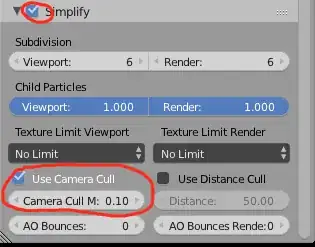

  3. Use Camera Cull:
    This is the most drastic of the options here. It will actually exclude objects outside of the camera view from the BVH Tree. When using this, you have to be careful not to get weird flickers from objects coming in and out of the camera margin. After enabling it in the Scene settings, you have to individually enable culling for each object in the Object settings:
