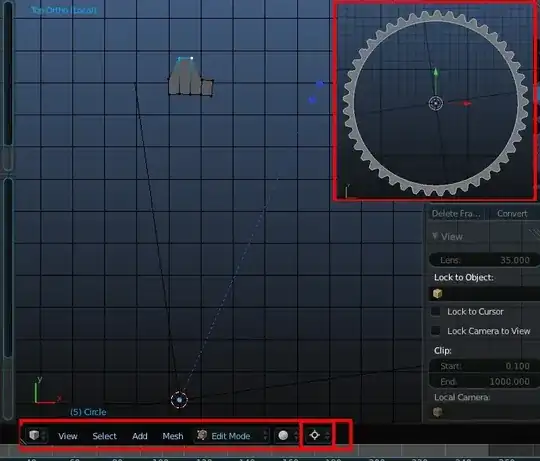

For creating a good gear simply, my advice is to create a little part of your gear and then use an array modifier with an object offset which is rotated. With that you can simply change the size or the form of your cogs.
You can easily do this if you follow this step:
First you need to fix the number of cog that you want. For the example I choose 45 cogs. Then add a circle with 4*numbers of cog vertices. 4*45 in my case. So now we have a circle with 180 vertices. enter image description here
Add an empty at the exact place of your circle. Rotate your empty of 360/number of cogs degrees in the Z axis enter image description here
Now add an array modifier on your circle. Put the number of cogs in the count parameter and put your empty in the object offset.
Now, in edit mode, you can extrude all your circle and delete all the faces except 4 of them.
Now put your 3d cursor in the origin of your object, change the pivot point to 3D cursor, select to vertices on the top of your 4 faces and scale them. You should have this: enter image description here If you pass to object mode, you have your full gear.
Now you can edit your cog and all the gear will be like the cog that you have done. Here is a little example: enter image description here
