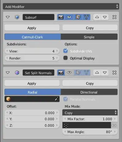

Quick Method
Basically, what we want to do is find the Dot Product between the normals of a bounding ellipsoid projected on to the mesh, and the normals of the mesh. First, enable Auto Smooth normals.
Next, add a Normal Edit modifier after a Subsurf Modifier (4 to 5 subdivisions) and set the Angle on the Normal Edit modifier to about 80 degrees. This will give us the approximate projected normals of the bounding ellipsoid.
Finally, add a Geometry Node and take the Dot Product of the (modified) Normal and (original) True Normal inputs (with vector transform) (it doesn't matter).
![enter image description here

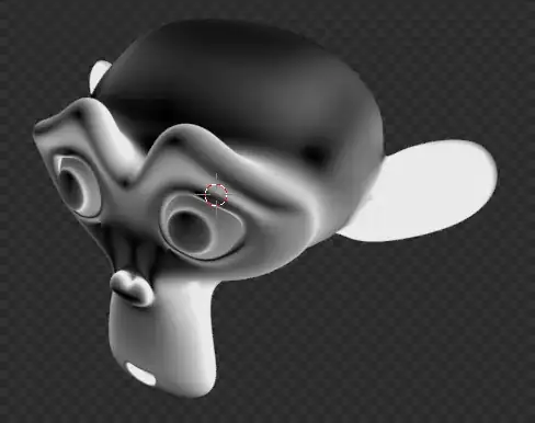

Result:
To increase the contrast, you can square the output with a Math node.
