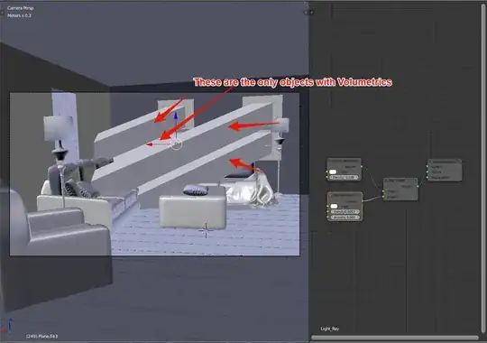

This single frame took about 2 Hours to render. I plan on making an animation with this scene, so something needs to be done about that. I have all lights (The two Lamps and a sun) set to one bounce. Yes, I am using volumetrics, however I have them set up so it should be minimal;
I'm suspecting its polygons, but I'm not entirely sure. If anyone could check out my file and see if theres a genuine problem with it or if its just some setting I have switched.

  • Before looking at the comments, I thought...bake...remove volumetrics. Like PGmath said, that is definitely the direction to go. On the other hand, (this will be far less effective) you could do some other tricks to reduce noise with decreased samples. I would suggest making the volumetrics only visible to the camera by unchecking everything else in the object settings, and make sure there are very few bounces. – JakeD Dec 12 '16 at 16:47
