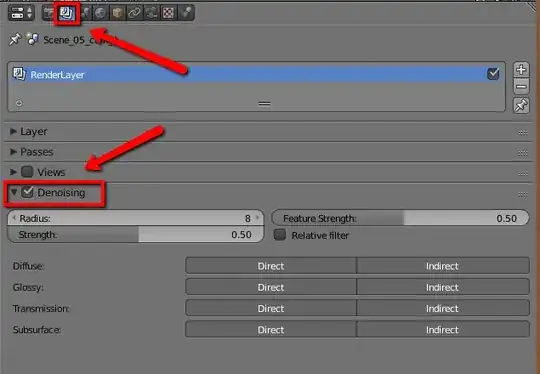

Since Blender Version 2.79 there is finally the "Denoise" feature!!
In some cases now e.g. for 1920 * 1080 pixels only 100 samples gives me better results with Denoise enabled then rendering the same Scene with 1000 samples.
This reduces the render duration to 1/10 while the result is even better!

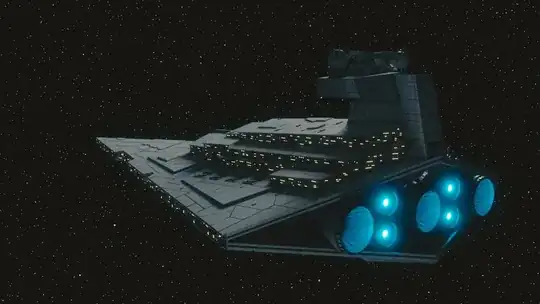

This first image was rendered with 1000 samples without Denoise enabled (render time about 20 minutes):
without denoise

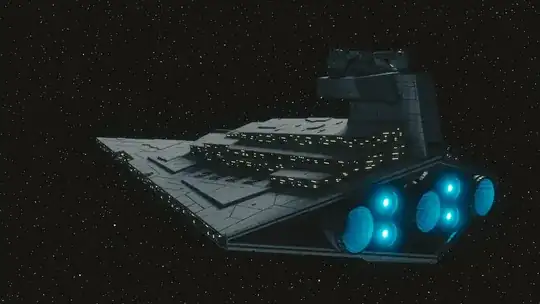

This second image was rendered with 100 samples and Denoise enabled (default settings) (render time about 2 minutes) with denoise
The result is basically the same but especially in the blue parts you can see that the second image has even a better quality though rendered in 1/10 of the time.

    I'd be carefully to say, that your denoised example has an "even a better quality" than image with high samples. Although I don't know your model, the denoiser seems to have introduced new artefacts, which are going to flicker in animation. – Leander Jul 29 '18 at 13:48
    @Leander yes ofcourse this might be true for animations .. but for a single image this is a huge improvement anyway – derHugo Jul 30 '18 at 07:39
