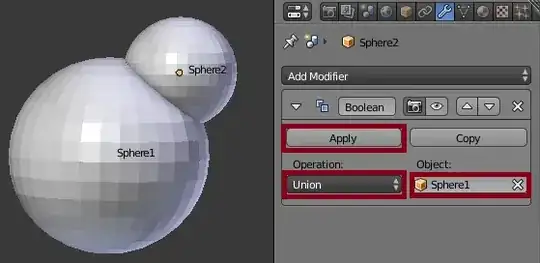

If you wanted to merge two spheres into a single object and remove the hidden vertices, do the following.
  1. Add a Boolean Modifier to one of the spheres.
  2. Set the other sphere under the Object in the Modifier Tab.
  3. Set the Operation to Union
  4. Apply the modifier.
Boolean operation
  1. Delete the other sphere.
This will cause problem with smooth shading. (Triangles)
Triangles in smooth shaded mesh
With spheres there is an easy fix. We can use the topological features of the spheres to get rid of topology problems. Do the following steps before the boolean operation.
  1. Select one of the spheres and add a Damped Track Modifier, with the other sphere as the Target.
  2. Do the same vice versa (with the other sphere).
  3. Set one of the Damped Track Contraints to To: Z and the other to To: -Z.
Track to constraints with z orientation
  1. Select both spheres and Apply Visual Transform (Ctrl+A > V). (Optional)
  1. You can now delete the constraints.
Do the Boolean operation and delete the unused sphere as explained above.
  1. In edit mode, select all A then remove doubles W > R
Smooth shading now looks fine, add edge loops to sharpen the crease.
With different objects, you will have to use different approaches to get clean topology with boolean operations.
