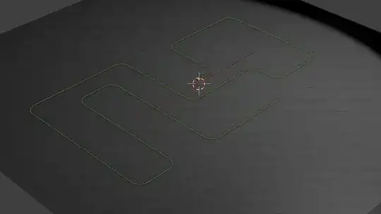

There are a few methods that you could use to achieve this, some simpler, some more flexible. The one that follows can give you results similar to what's shown in the video.
First create a curve object that roughly follows your desired path, bevel its corners so you get less distortion on tight curves. In this example I use the great Curve Fillet Tool addon from the Blender CG Cookie Market (it's a paid extension, but worth the price IMHO), you can also use the Simple Curves Addon or just do it manually if you prefer.
Add curve
