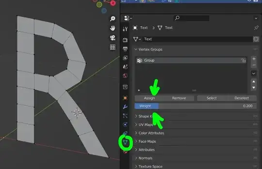

If the Boolean modifier doesn't satisfy you, you could try it with the Mask modifier. It's a bit tedious but it works:
Give a vertex group to your object, assign a decreasing weight to the vertices all along the path of the letter:
At the end it should look like something like this:
Give your object a Mask modifier, choose the vertex you've created. Give it a Solidify modifier in order to give it thickness:
Now animate the Threshold value of the Mask in order to make the letter appear:
