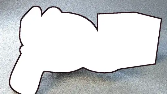

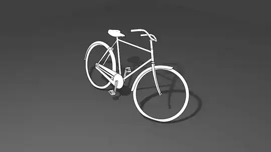

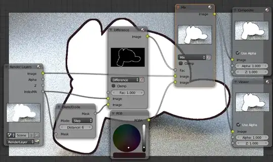

Render your scene twice. First in cycles and then in Blender Internal. Leave cycles materials in BI and change the alpha to transparent in the shading setting. There will be edges only in BI. When you get both of your scenes rendered. Use the compositor with the "alpha over" node.
If you want your human to be a shadeless white, you could use a material index node in Cycles that creates a mask of your object without shadows but it will still cast shadows under image.
Node setup:
Test render:
Daniel
  • 3,624
  • 59
Utas
  • 844

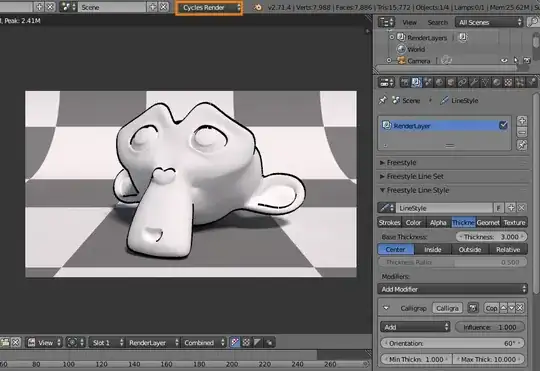

Update
Freestyle is natively supported in cycles as of this commit (will be in 2.72). This means that you can do exactly as in Utas's answer, but without the extra scene/renderlayer.

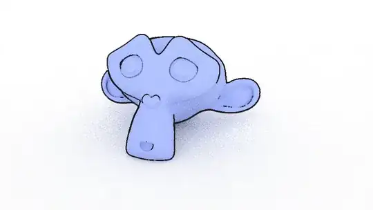

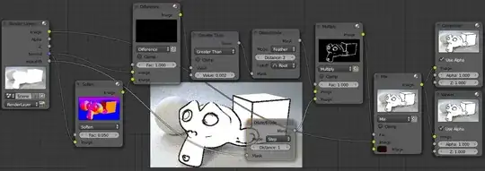

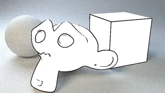

You could try using this node setup, it works with composite nodes and is render engine independent.
Here is an example render:

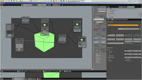

Method one:
You can get outlines by using the index passes:
  1. Enable the Material Index pass in Renderlayers > Passes:
  2. Create a new material and set the Pass Index in Properties > Material > Settings:
  3. Create the material:
You can then use the pass index to create an outline in compositing nodes:
Note that a limitation is that overlapping objects will not have lines between them:
This can be worked around by using the object Index for each object individually, however for large scenes this is probably too tedious.
Method two:
Another way is with the Filter node:
  1. Repeat steps 1-3 from method one.
  2. Enable the Normal pass in Render layers > Passes:
  3. Use the normal pass to create lines, then limit the lines with the material index pass: (click for full size):
Result:

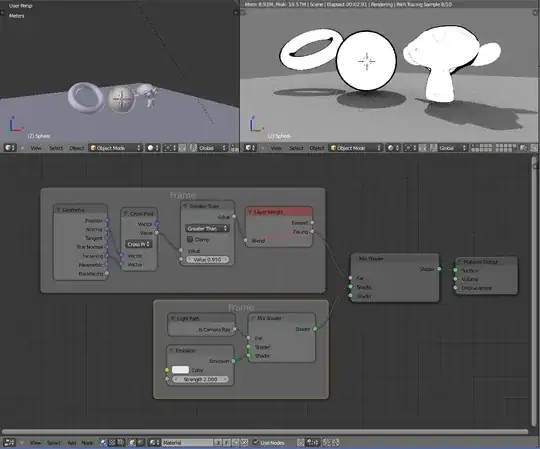

I tried solving the problem you have posed and could achieve the following result using Cycles shader nodes.
I have used the cross product between the shading normal and incoming direction vector and passed it to a math node whose output is fed to the mix shader that plugs in to the material's surface socket. The mix shader is fed with another mix shader which feeds an emission shader for the camera ray, otherwise the output of second mix is black.
Cycles Silhouette
Link to high-res version: http://www.pasteall.org/pic/show.php?id=52714
satishgoda
  • 8,064
  • 35
  • looks nice, thanks for your proposition :) But the biggest part of the problem is to get the humans white (for the camera only, achieved with an emission shader) but casting shadows (not emitting light for the environment). – matali Jun 02 '13 at 15:20
  • I have worked out a solution and have edited my original answer. The silhouettes are not that well defined for very curved objects though.. – satishgoda Jun 03 '13 at 04:08
  • thanks a lot satishgoda, it's really near from what I want to achieve :) I have to test it when I'm back home. – matali Jun 03 '13 at 12:30
  • Great.. Let me know how it goes. I am still trying to figure a way out to get consistent silhouettes. – satishgoda Jun 03 '13 at 13:08

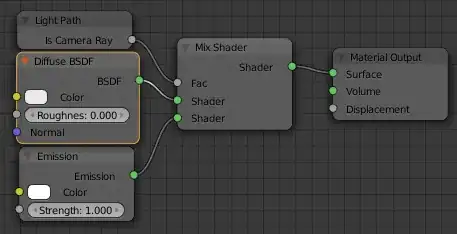

In the Materials panel, in the top right, there should be a drop-down menu with 'Data' selected. Open the menu and select 'Object' instead. Then, if you use an Emission shader, the object will still cast a shadow (although a weak one), and will not affect the lighting on other objects.

  • hmm, not sure why, but it now works in both data and object mode with strength connected to "is camera ray" from the "light path" node. I compiled latest SVN too, so it was maybe due to a bug, no idea... anyway geting 100% white objects with shadows and no light emission now works :) thanks – matali Jun 02 '13 at 16:51
In cycles, use a mix shader between emission and diffuse. Set the factor to be Input > Light Paths > Is Camera Ray. Hope this helps!

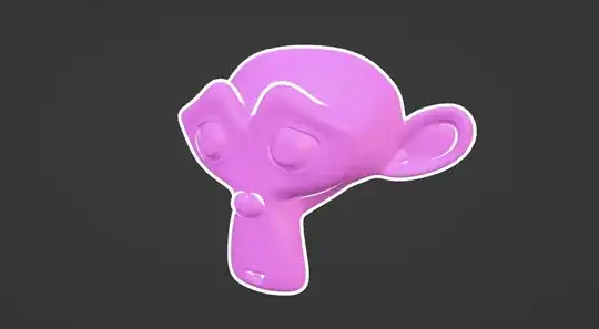

You can use a nice trick (specifically in my case I needed outline only for some objects in my scene) - Solidified mesh with flipped normals.
There are two ways Geometry nodes ...

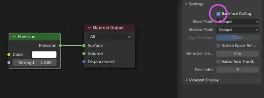

... object has assigned two materials. Pink material at first slot is automatically used for whole object. For flipped faces assign white material - Emit shader and enable Backface Culling in material properties.
Another way is to use Solidify modifier and enable Flip Normals and Material Offset > 1.
Source https://www.youtube.com/watch?v=EsY7FdNFOoQ
