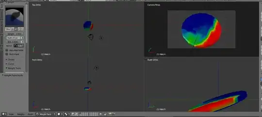

  1. To partially cover the watch with sand, use vertex weights. This requires going into 'weight paint' and using the brush to indicate where you want the sand grains to overlay the watch. For the image above, this weight painting was used. The red color indicates where sand grains will be dense and deep blue indicates where the sand will be absent.
watch vertex weights
  1. Set up the sand particle system on the watch. However, to control where the grains go, use the vertext groups and specify the 'group' vertext group. This will refer to the vertext weights generated in step 4.
watch particle settings
