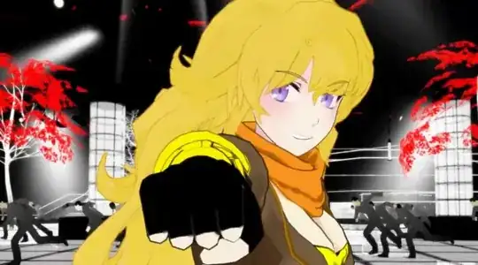

I've been trying to produce an outline in blender render (Simmilar to this- from the show RWBY)
I am trying to do it using this technique: Duplicating an object, scaling it up slightly, giving it a black texture, enabling backface culling. However, this never apears in the render as it's aperently just used for the 3d view (as far as I know). I need help getting blender to render backface culling within the "Blender Render" engine, not cycles. I was wondering if anyone had tips, or perhaps a script that could help me solve this problem. Thank you
