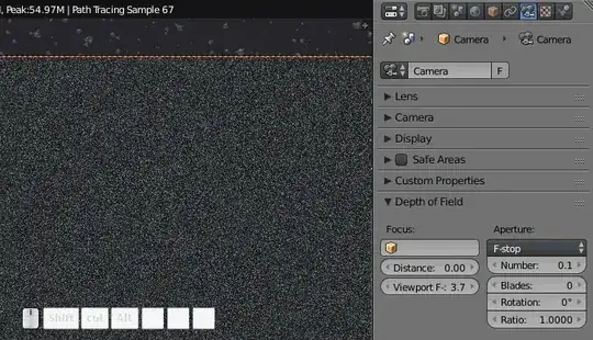

It sounds like you have set up the camera already, but for completeness here are some settings to keep in mind:
Set the aperture size to be fairly large in order to get a shallow depth of field. When setting the aperture size directly in terms of it's radius in BU, larger values mean a larger aperture. A value of 1 is really big (1 BU = 1 meter), you'll likely want something not much bigger than .1.
You can also set the aperture size in terms of f-stops, in which case smaller values mean a larger aperture. This is mainly useful when you have a particular look you want to replicate (e.g. from a photograph), or if you're just more familiar with f-numbers.
The number of Blades in the aperture controls the number of sides on the bokeh. Values below three will make the bokeh circular. The Rotation setting rotates the aperture. This is useful for making the bokeh less straight and perfect looking.
For example, with 7 blades an little rotation:
Setting the Ratio to a value besides 1 will stretch the bokeh, simulating an anamorphic lens:
And of course you'll want to set the Focus. I usually set an empty as the focus object:
But you can also set the Distance by clicking in the 3D view:

The Viewport F-stop is used to set the size of the viewport aperture for approximating DoF real-time in the viewport. Note that this approximation is only active while in camera view (Numpad 0) with Depth of Field enabled in 3D view > Properties (N) > Shading:
enter image description here One thing you might have noticed, is that the cycles aperture and the viewport aperture give very different results.
This is because the viewport DOF is not as accurate as the cycles DOF.
To solve this issue, in Blender 2.75, there will be a new high quality checkbox for the viewport, that gives a more accurate approximation of dof.
When enabled using the same settings, it looks like this
