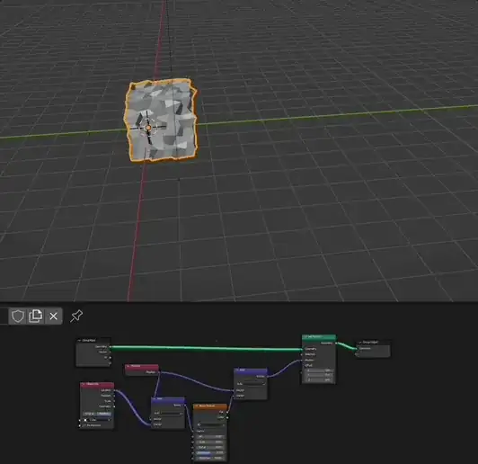

I have a cube with a subdivision surface. I'm using the set position node, and a noise texture, to make the object bumpy. (See Photo) When I duplicate the object, I'd like the location of the noise to be randomly different on the other object. Is there a way to randomize the vector location of the noise texture per-object? Thanks!

you can use this node setup:
result:
Note: but yes, if it would be the same location, it would be the same noise...

  • Not random and varies as the object moves when it's animated. – Marty Fouts Jan 25 '22 at 05:13
  • nobody said the the object is animated....and of course it is random - and if it isn't "enough" random, you could use a math multiply before after location and before add. – Chris Jan 25 '22 at 05:23

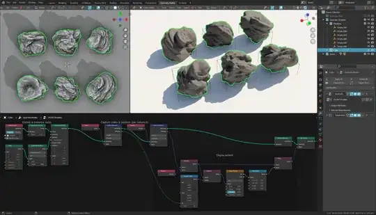

Variant 2
Control via Index
Another option would be to feed this variable value into a node tree from the outside, and create all objects in this one tree.
This could look like this:
Here I first create several Empties in a Collection. I use these as positions for the individual rocks.
Then I first use the node Collection Info in the node tree and instantiate several cubes at the positions of the Empties in it.
After that I capture the index and the position of the instances. The index is crucial here, because with this unique value per instance I can now control the displacement.
Unlike the previous variant, however, the position of the individual objects is always relative to the zero point of the object in which the nodes operate.
Therefore, I also capture the position of the instances to be able to compensate for this difference and achieve a displacement from the center of each individual object.
(Blender 3.2)
