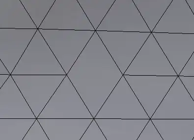

I run into this issue all the time and it's really frustrating to fix especially on high poly meshes. Either there's no face joining some edges ("zero-area hole"?) or there is a zero-area face. Either way it messes with the normals making ugly black spots all over the mesh. Here's an example:
To fix the normals I'd quite like to either...
  • split the upper face, as the dashed line shows,
  • or merge the two lower faces by dissolving the edge, as the cross shows.
How can I do this automatically to the entire mesh?
Manual methods aren't acceptable as there's a lot of this kind of geometry. I'd prefer to change the mesh as little as possible, or at least not lose any information by collapsing huge areas.

Below is an example of a zero-area hole, although I've moved the vertex up so you can see it.
You can get the zero-area faces back with Mesh->Clean up->Fill Holes.
Even if I do manage to manage to get rid of the zero-area face, leaving a quad as shown below, I've found triangulating it splits the wrong way and just gives a zero-area face again (this really seems like a bug in blender's triangulation).

There is a tool specifically for this.
  • First select all faces (typically selecting the entire mesh is fine).
  • Access this menu item from the 3D View: Mesh -> Cleanup -> Degenerate Dissolve to remove zero area faces, zero length edges.
Using dissolve is useful because it won't make holes where the faces used to be, it simply removes the face and merges surrounding edges.
you can change the threshold as a tool option.

Thanks to @ideasman42 and @LeonCheung for their solutions! I've combined them here and show an example.
Whether there are gaps in the mesh as in the following:
enter image description hereenter image description here
Or zero-area faces as below:
They can be fixed like so:
  1. If there are holes, Mesh->Clean up->Fill Holes to create zero-area faces. The next step won't work without it.
  2. Mesh->Cleanup->Degenerate Dissolve as in @ideasman42's answer. In my example I'm left with a quad. NOTE: I've still found a few broken faces with only one iteration, so run it a few times. Be careful not to set the threshold too high.
  3. Triangulate, using CtrlT or CtrlShiftT as @LeonCheung says. The latter worked for me. Changing the Quad Method in the t panel (or with F6) also worked.
    Doing this in blender is quite an important step for me because leaving as quads gives a good chance that other applications down the line do the triangulation and get it wrong.
