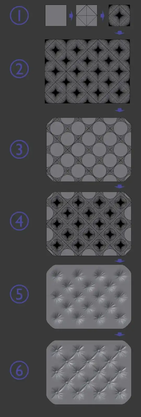

The following workflow is recomended:
Method 1:
  1. Create unit mesh;
  2. Array modifers;
  3. Bevel modifier (type: Vertex Group);
  4. Apply modifiers, inset ngons, then poke;
  5. Proportional edit (type: Random)
  6. refinement.
For Step 1:
For Step 5:
Example file for Method 1
Tip: Things can be much faster by using Select Similar operator (ShiftG) while processing.

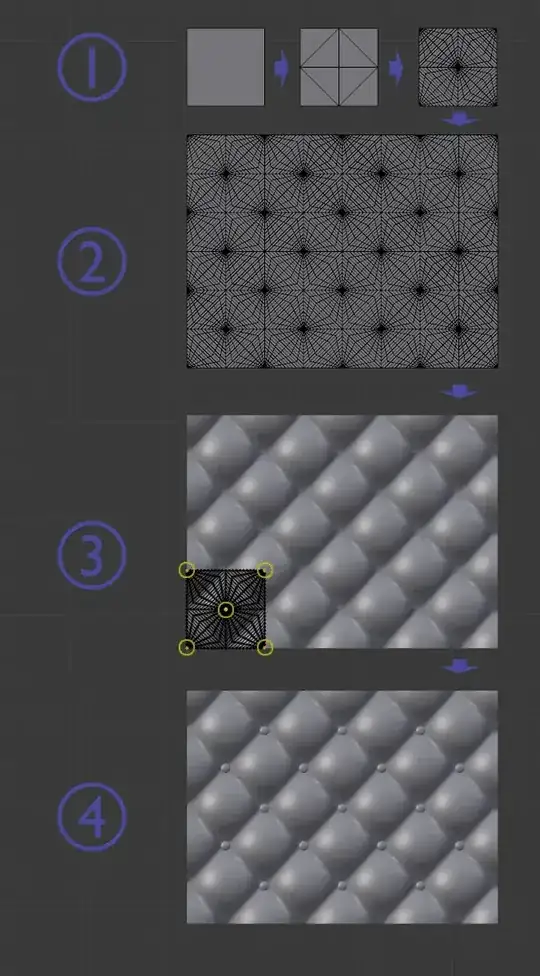

Method 2:
  2. Array modifiers;
  3. Translate the four corners and one center vert with Proportional Editing Falloff.
  4. Refinement.
For Step 3:
Example file for Method 2
Note: Comparing with Method 1, the topology is cleaner with less wrinkles, which may be less realstic, but could probably be expected.

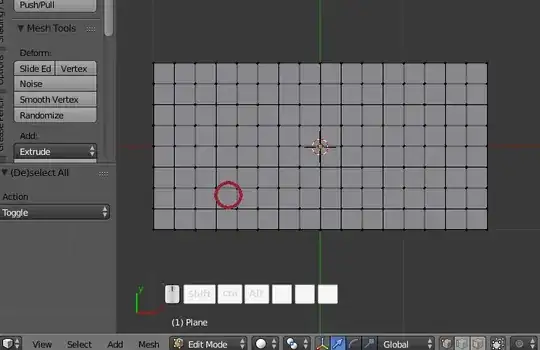

  2. Subdivide it as evenly as possible (starting with square sections means you will end up with square sections):
  3. Select the inner vertices with Box select (B)
  4. Checker deselect 3D view > Header > Select:

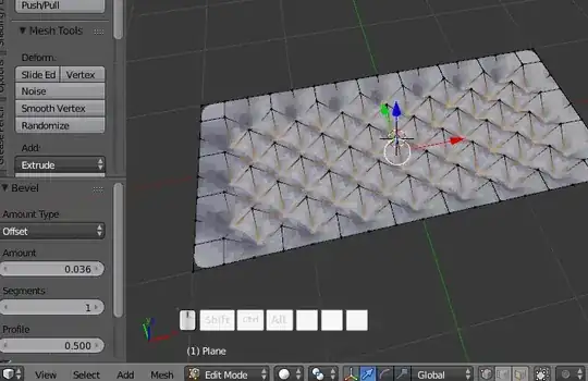

  5. Move those vertices down on the Z (GZ), add a subsurf modifier (⎈ Ctrl2 where 2 refers to the number of view port subdivisions) and bevel them (⎈ Ctrl⇧ ShiftB):

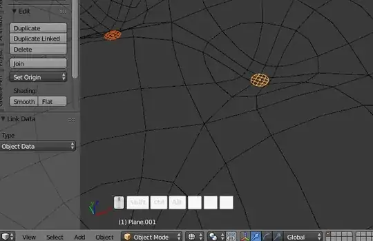

  7. Recenter the origins of all the faces (⎈ Ctrl⇧ Shift⎇ AltC> Origin to geometry), then pick one button to be the main button. With that button active (brighter yellow outline), press ⎈ CtrlL> Object data:
    Now changes to one button in edit mode will affect all the buttons.
