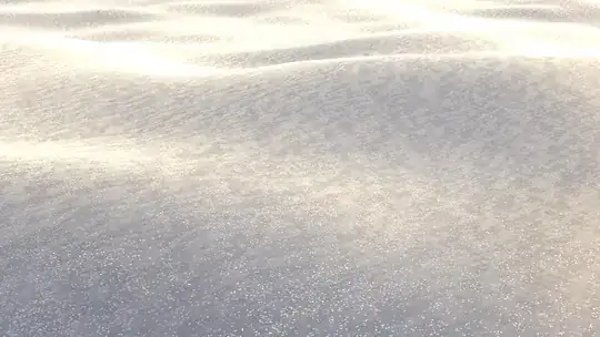

I'm looking for some way to capture the displacement, both small and large, the bright highlights of glistening snow, and the subtle grain over all.
Here are two reference images I took last winter.
close up of snow snow
