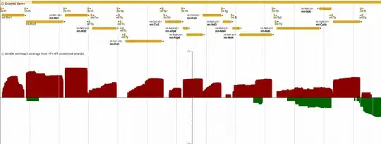

If this has worked properly, then mapping human or mouse to the mitochondrial genome should show most expression appearing on the positive strand, with a small scattering of negative-strand expression, a bit like this:
mtDNA transcript expression (nanopore)
For a bit of a background on how/why this works, see this answer.
