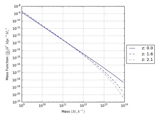

The number of galaxies in the "wall", as in any volume of space, is the number density $n_{\mathrm{gal}}$ times its volume $V_{\mathrm{wall}}$. However, the number density of galaxies depends on their masses/sizes: Small galaxies are much more common than large galaxies. Usually we describe this by the halo mass function (HMF), which gives the (differential) number density dN/dM of dark matter halos hosting galaxies as a function of halo mass M. Depending on your favorite cosmology, it looks something like this (created with this tool):
Halo mass function
The solid line shows the HMF today in the local Universe, i.e. at redshift zero, while the dashed and dotted line shows how it was at redshift 1.6 and 2.1, respectively, roughly 10 billion years ago, which mark the beginning and end of the wall (according to Horváth et al. 2014, A&A, 561, L12). Notice how the number of large halos grow with time, at the expense of small halos. This is due to the smaller ones accreting onto larger ones.
The HMFs are characterized by a power law at low masses with an exponential cut-off at high masses. To get the total number density we need to integrate over the entire range of masses, and here comes the problem: Whereas the upper limit is set by the maximum size a galaxy can have (roughly $3\times10^{13}M_\odot$, but the exact number isn't very important, as these galaxies are so rare), the lower limit depends on your definition of a galaxy. Large galaxies have smaller galaxies orbiting as satellites, and there isn't a well-defined threshold for when a clump of gas, stars, and dark matter is called a galaxy. These guys report on the detection of a $\sim10^3M_\odot$ clump which they call a galaxy. That's probably not what you think of as a galaxy, so for the sake of this exercise, let's use Small Magellanic Cloud-sized galaxies as our lower minimum, i.e $\sim 6.5\times10^9 M_\odot$.

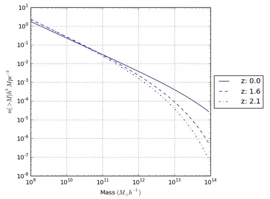

The total number density of galaxies is thus found by integrating the HMF. Luckily, the online HMF tool can do that as well. The result, i.e. the number density of halos above a given mass, looks like this:
Cumulative HMF
Note that the $x$ axis is given in terms of $h^{-1}M_\odot$. Since $h \simeq 0.7$, the mass of the SMC is $M_\mathrm{SMC} \simeq 5\times10^9 h^{-1}M_\odot$. From the graph, the number density of these objects is $\sim0.5\,h^3\mathrm{Mpc}^{-3} = 0.17\,\mathrm{Mpc}^{-3}$ (1 Mpc, or megaparsec, equals 3.26 million lightyears). In principle we should subtract the number density of halos above $3\times10^{13}M_\odot$, but since these are four orders of magnitude smaller, they can be neglected.
