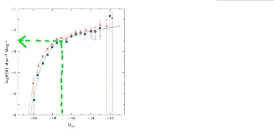

The figure below (from Wyder et al. 2005) shows the local-Universe luminosity function for UV-selected galaxies. That is, it shows the number density of galaxies at a given magnitude. For instance, it shows (with the green dashed line) that the number density (here called $\Phi$) of galaxies with magnitudes around $M=-17$ is roughly $10^{-2.5}\sim0.003\,\mathrm{Mpc}^{-3}\,\mathrm{mag}^{-1}$.
UVLF
Integrating over magnitudes from the $M=-17$ doesn't change the 0.003 much, since the density of brighter galaxies quckly declines. I get 0.004, i.e. the number density of galaxies at least as bright as $M=-17$ is $0.004\,\mathrm{Mpc}^{-3}$, smaller than the theoretical result above by 1.5 orders of magnitude. Multiplying this by the volume $V$ and the relative density $\delta$ yields $N_\mathrm{gal,Böotes} \simeq 100$ galaxies, not far from the 60 you quote.
To conclude, the number 60 seems in rough accordance with what is expected observationally, but theoretically, we'd expect there to be many more galaxies (although they're very small).

  • Wait - tbc 0.17 Mpc-3 is indeed "typical galactic density of the universe" {at the "Small Magellanic Cloud" metric level}, is that right? Thanks for this! – Fattie Jun 06 '16 at 13:03
  • Thanks again for this. Is brilliant. My immediate question: I'm bamboozled by the "60" figure. If there's on the order of 4000 galaxies "in the Boötes Void", it seems to me nonsensical, on a number of levels, that "60" were found, and indeed, apparently those 60 happened to be "in the tube". If we interpret "the tube" as indeed an overdensity amongst the 4000 - something is confused. {Or, is the idea that the BV is utterly empty, except for, *4000 in a tube*?} {Indeed, is it actually correct that the 60 are "in the tube", or is this some misquote along the way?} – Fattie Jun 06 '16 at 13:08
  • @JoeBlow: The 0.17 Mpc$^{-3}$ was calculated under certain assumptions, e.g. the cosmological parameters. Observational constraints on the number are challinging, since all observations probe only a subset of galaxies corresponding to the selection criteria. But I'd say that the 0.17 is a good estimate. – pela Jun 06 '16 at 14:36
  • But since the void is so far away, you won't be able to see so small galaxies as the SMC, only the brighter ones. As far as I can see, the detected galaxies actually lie in a "tube". It is probably a filament extending across the void, hosting the largest galaxies which are then the only ones we can see. – pela Jun 06 '16 at 14:37
  • Note also that there is a redshift dependence for the number density, although this is mostly important for large galaxies that form late. – pela Jun 06 '16 at 14:38

  • Hmm… it seems SMC-like galaxies would almost have been detected in those surveys. I updated the answer based on our discussion. – pela Jun 07 '16 at 10:26
