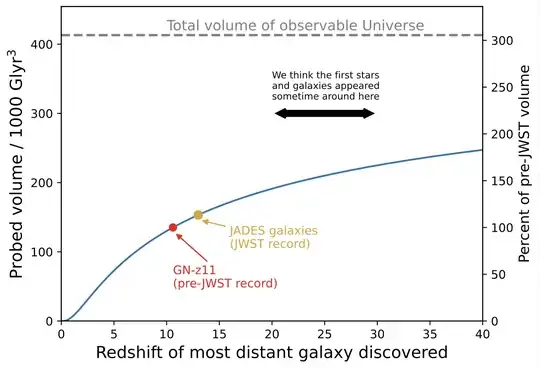

  • @BradV I added a figure that show you how the volume increases with observed redshift. – pela Jan 30 '24 at 22:45

The plot below shows the probed volume as a function of the redshift of the most distant known galaxy. Since the very first galaxies are thought to form at $z\simeq20\text{–}30$, an increase of more than $\sim50\%$ is unlikely. But stay tuned; I'll update this plot along the way :)
