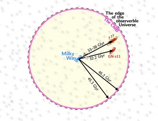

The figure below is pretty much to scale:
obs-uni

    "The figure below is pretty much to scale:" - apart from the size and density of galaxies which is vastly out of scale ;-) – asdfex Apr 03 '22 at 11:30
  • @asdfex AND... does not show home of LGM – BradV Apr 03 '22 at 19:56
    @asdfex Okay, the galaxies aren't, but the telescopes are indeed 4 billion lightyears long ;-) – pela Apr 03 '22 at 22:09
