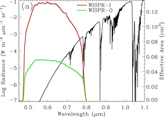

There's actually a paper by Wood et al. (2022) that came out focused on this. It discusses the expected detection given the expected emission (using a model that combines the surface emission and the emission and radiative transfer through the Venusian atmosphere). They do mention checking to see if the detector might have been more sensitive than assumed, but the answer seems to be no:
... one concern is whether a red leak might exist for the WISPR optics that could account for the detected emission. Additional laboratory measurements were made using analogs of those optics in order to look for any indication of throughput above 0.8 μm, but no evidence for such a leak was found.
The discussion in the paper clearly indicates that the observations are consistent with what was known about Venus and the imager. E.g.,
Further evidence that we are seeing thermal surface-emission within WISPR's optical bandpass comes from demonstrating that the WISPR count rates are consistent with model predictions.
and
... the model spectrum exhibits a broadband attenuation of about a factor of 4 due to absorption from the sulfuric acid clouds. The opacity of the thick atmosphere leads to significant blurring. This effect is presumably why the WISPR images do not show a finer scale structure.
enter image description here Part of Figure 3 from the paper, showing "A model spectrum of the surface thermal emission from Venus, assuming a temperature of 735 K (left axis). Also shown are the effective area curves of Wide-Field Imager for Parker Solar Probe (WISPR) WISPR-I and WISPR-O (right axis)."
and
Integrating over wavelength, the count rates predicted for WISPR-I and -O are 40.0 DN/s and 33.5 DN/s, respectively. The 33.5 DN/s WISPR-O prediction is in very good agreement with the zero-altitude value displayed in Figure 2
(The zero-altitude value in their Figure 2 is between 30 and 35 DN/s.)
