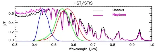

Here is the top half of Figure 1 from the Irwin et al. paper:
"Human eye" curves are compared with Hubble Space Telescope spectra of the two planets. A couple things to note: Neptune is slightly more reflective where human blue optical cones peak, while Uranus is slightly more reflective where the red cones peak. So this is the color difference that the OP was asking and answering about. These Hubble observations of Uranus and Neptune were already published in 2009 and 2011 based on 2002 and 2003 observations.

In the new Irwin et al. model, the main factors affecting the visible color of the two planets---the differences between the pink and black lines above---are more gaseous methane on Neptune (making Neptune less reflective than Uranus at red wavelengths), and more haze particles in one of Uranus' layers (making Uranus less reflective than Neptune at blue wavelengths).
