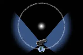

above: Profoundly not-to-scale illustration of NEOCam in an orbit around the Sun-Earth libration point L1, about 1.5 million kilometers from Earth. Presumably Sun-shield and Earth-shield block light (both infrared and visible) from the Sun and the Earth in order for the instrument to work at cold temperature necessary to detect the faint infrared light radiated from NEOs.
