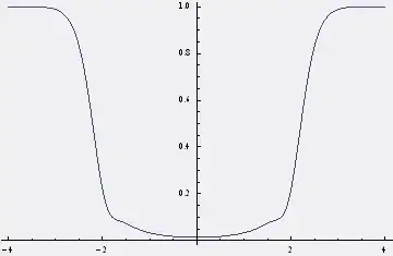

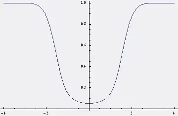

This is what you get from a mono-directional continuum source falling from one side onto an isothermal purely scattering plane-parallel layer with a line center optical depth $\tau$=10 (assuming a Doppler (Gausian) scattering emissivity) for the transmitted line at the other end (looking vertically into the layer and including the continuum source)
Transmitted $\tau$=10

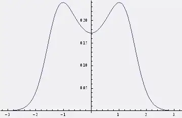

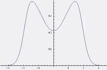

and this is what is being vertically reflected back to the continuum source
Reflected $\tau$=10 enter image description here
Here is the same for an optical depth $\tau$=100 instead
Transmitted $\tau$=100 enter image description here
Reflected $\tau$=100 enter image description here
If one looks at the actual numerical scale of the graphs, it is obvious that the amount reflected back does not fully explain the amount missing from the continuum on the other side. This is simply due to the fact these plots hold for a fixed (vertical) viewing direction only and are furthermore normalized to a solid angle of 1 steradian (which is only 1/2/$\pi$ of the full half-space the radiation is scattered back into). If one would add up the back-scattered radiation over the complete half-space, taking also into account that the line shape and intensity varies with the viewing direction, it would exactly account for the radiation that is missing in the transmitted spectrum. The question the OP had can only be answered in this way.
