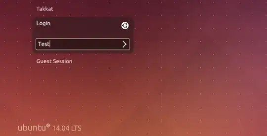

I used to modify /etc/lightdm/lightdm.conf, adding the line greeter-show-manual-login=true, in order to allow login for hidden users and root.
Now I've just installed the new Ubuntu 14.04 and the file lightdm.conf is no longer located in /etc/lightdm. It's in /etc/init and has been totally modified.
How can I force lightdm login screen to show a field to input a login name?

Ok I finally found the solution, very simple. The file to edit is now located in /usr/share/lightdm/lightdm.conf.d, and is called: 50-ubuntu.conf.
I just added the line:
and on next reboot I was able to input any user name on the login screen.

I also had the same issue with Ubuntu 14.04 installation. But I resolved the problem by following this site.
The solution is to create a file lightdm.conf inside /etc/lightdm/ and put the following contents in it:
[SeatDefaults]
After a system reboot, I was able to login with other users.

In addition to the greeter-show-manual-login=true option, one could use greeter-hide-users=true. Personally that's that I have in my /etc/lightdm/lightdm.conf : the manual login option is commented out, with only hide users option left.
