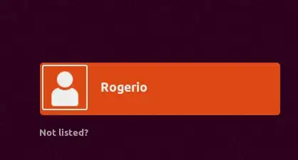

I'm using Ubuntu 18.04 LTS on Vmware.
I followed these instructions: https://www.youtube.com/watch?v=pdyy7icpgbQ
But when restarting, I'm getting this: enter image description here
Instead of this:
... as shown in the video.
How to enable the login as root?

After reboot, you will reach login screen where there will be a display of not listed? option just under username. If you click it, you will get another screen where you can enter root as username and then press next button. Now, the next screen appears which collects password. You enter root password. After successful authentication you will be logged in as root.

Questioner @Rogério Dec attempts to look for username root from lightdm login screen.
This procedure is for gnome GDM according to the youtube video.

  • Thanks, I did your steps but it seems to have made no difference. To confirm the steps I performed, I posted a video on the original question so you can track what I may be doing wrong. – Rogério Dec May 06 '19 at 16:24
  • You are in lightdm whereas this root-login procedure is for gdm. So you need to switch to gdm for root-login to work. If you issue this command cat /etc/X11/default-display-manager, the ouput on your terminal will be /usr/sbin/lightdm. Suppose the output is /usr/sbin/gdm3, then the root-login process will work. Please follow up the Conclusion part of the answer in order to switch to gdm. If you have more questions, please let me know! – Marmayogi May 06 '19 at 16:45
  • Suppose you don't want to switch to gdm and you want continue with lightdm display manager and still want to do root-login. Then you should follow https://askubuntu.com/questions/451950/how-to-configure-lightdm-to-allow-manual-logins-in-ubuntu-14-04. A word of caution: this link offers solution for Ubuntu 14.04 lightdm but your version of ubuntu is 18.04. So, please double-check before using the solution. – Marmayogi May 06 '19 at 16:57
  • I did the "Conclusion" step, but now I can't log in anymore, even with my old user. I inserted 2 images at the end of the original post to illustrate. – Rogério Dec May 06 '19 at 21:45
  • I restored a backup from my virtual machine and redid the steps. I noticed that after sudo dpkg-reconfigure gdm3 I get gdm.service is not active, cannot reload. invoke-rc.d: initscript gdm3, action "reload" failed. – Rogério Dec May 06 '19 at 21:55
