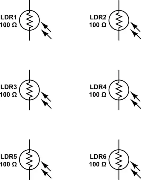

I am planning to place 6 light sensors in 1 meter (or maybe more) distance from one another, like this (sorry about the bad schematic, I am not an expert, but I hope it makes sense):
schematic
simulate this circuit – Schematic created using CircuitLab
I am going to place them in a relatively dark room. My goal is, when I am pointing a flash light towards them to be able to tell which sensor is measuring the highest values (where the light is coming from), and for how long (in milliseconds).
I know how to do the connections and measure values. My questions are two:
  1. Which is the most efficient way to detect which of the 4 sensors is recording the higher values? I am assuming I have to compare the values that they are recording. However, I think that if in each loop I sort the captured values, the process might become heavy. I guess I could minimise the comparisons, since for example if LDR1's value is higher than LDR2 and LDR3, I can assume that the light source is cannot be pointing towards LDR6 for example. However, I am thinking that maybe there could be an even more efficient way to detect that (not necessarily in software).
  2. Since the room will not be completely dark, the analog pins will record some values even when I am not pointing the flash light towards them. Is there a way to filter that out? I have come across calibration (https://www.arduino.cc/en/tutorial/calibration), but I am not sure whether this is the optimal solution. Please take into account that the light source might not be very strong (but its light will definitely be brighter than the room light).

  • This will most likely do it! I really like the second solution. However, in order to calibrate it, is the method that I posted in my question likely to work? I need to measure for how long the flash light was on (in milliseconds), so I guess I will need either some calibration or a high pass filter. – Iakovos Apr 02 '17 at 11:22
    @jackgu1988, see edit - although I guess I didn't address the ms on but instead fraction of on time in last .8 seconds (with constants shown) – James Waldby - jwpat7 Apr 02 '17 at 17:14
  • This will probably do it! Thank you very much. For the moment I am waiting for a couple more sensors to be delivered. I'll report back when I test it. – Iakovos Apr 02 '17 at 23:26

  • Thank you! This information is very helpful. I was also thinking that maybe I can wire the resistors in a way that I can minimise the amount of checks. For example, having 3 instead of 6 analog inputs (each input representing 2 sensors) and depending on the returned values to be able to tell which sensor is receiving more light. – Iakovos Apr 02 '17 at 10:39
    You could try to come up with clever ways to wire the photoresistors in serial and/or parallel to reduce the number of samples you need to take, but that's a pretty darn tricky thing to do. I would probably first start with adding more sensors and, if the loop is too slow due to the length of time it takes to sample all of them, figure out an algorithm to sample only some of the sensors and leave others alone based on what's been sampled recently. But first I'd get something really basic working. – cjs Apr 02 '17 at 11:59
