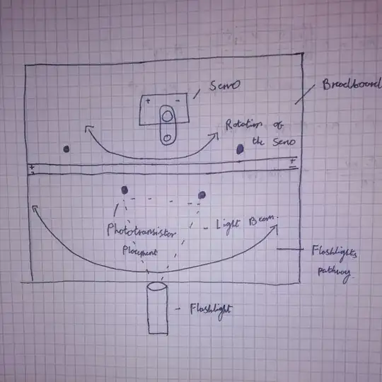

Explanation of my hardware setup:
This project is allocated on two connected breadboards which means that there are no moving parts. The only moving component is the one single servo that is fixed in position.
The phototransistors, (as mentioned above), are placed in a V configuration which too are stationary. The servo is allocated behind the phototransistors and can only rotate 180 degrees. (You can see the attached illustrations below, I apologize in advance for any technical errors or my horrible drawings.) Project Setup Illustration:
Connection Diagram:
As you can visualize on the first image, I do not plan on a complete 360 degree rotation which probably complicates the issue further. Any suggestions on how I can code this would be greatly appreciated! Once again thank you for your time.
    See this https://www.instructables.com/Arduino-Sunflower-an-Electronic-Sundancer/ or google for Arduino Sunflower or solar tracker for more examples. I believe the most effective ones have the light sensors mounted on the panel which the servos moves. The servos continues to position the panel until all photosensors deliver exactly the same measurement. Can you say something about the physical construction of your project. – 6v6gt Dec 25 '22 at 10:53
  • Thank you for your reply, the link you sent me was quite helpful however I have noticed that the project mentioned utilizes two servo motors for a full 360 degrees rotation (covering all three x, y, and z coordinates). I, unfortunately, have to resort to utilizing one servo motor which only provides me with 180 degrees. Another issue I have noticed is that the light sensors are not stationary and are rotated by a robot "chassis". Due to my project being entirely based on breadboards the method used will not work for my application. I hope my edit will clarify the idea a little bit better. – Alexander Watkins Dec 25 '22 at 22:27
    Your efforts are well thought out, but make use of others before you, e.g., https://arduino.stackexchange.com/questions/36597/detecting-the-light-source-location-using-multiple-photoresistors (yes, I know they are LDRs, but the task is similar). Also, make some effort to calibrate your phototransistors, even if it is just to check the levels when a light source is 6 inches away - they need to be as identical as possible and fixed 220s may not be good enough. Finally, remember you only have 1 ADC and are switching channels, check that you are obeying speed limits, so to speak. // end two cents. – DrG Dec 25 '22 at 22:46
  • Just to get started, I'd probably look at the photo transistor which gives the strongest light value and use that as the current starting point (0,60,120 or 180 degrees assuming that is how the transistors have been distributed around the servo) then look at the adjacent transistors to work out how much, and in which direction, to bias the result away from the starting point. The result is sent to the servo. Repeat every X ms. Your hardware configuration is unusual in that all the sensors are static. Most tracking type projects move the sensors towards the light source. – 6v6gt Dec 26 '22 at 00:23
  • This really helped! It took me a while but I managed to get it to kind of work. The servo is jittery but I am satisfied. I will attach a youtube URL later today to show my results. Thank you guys for replying! – Alexander Watkins Dec 26 '22 at 11:11
