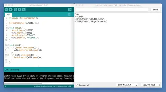

Thank you for the answer @Holmez, third link was very helpful. I was just change the code and the RX, TX pins like below and it works perfect now. I can send commands to the ESP both in program and over the serial monitor.
#include <SoftwareSerial.h>
SoftwareSerial wifi(10, 11);
void setup() {
  Serial.begin(115200);
  wifi.begin(115200);
  Serial.println("Test");
  wifi.println("AT+CIFSR");
void loop() {
  if (Serial.available()) {
    wifi.write(Serial.read());
  if (wifi.available()) {
    Serial.write(wifi.read());
