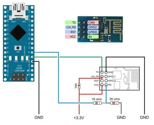

I am attempting to connect and use an ESP8266 board with my Arduino nano v3.0 and I am not have much luck.
I have read a bunch of tutorials and articles, the most recent is http://elektro-blogger.blogspot.co.nz/2015/07/arduino-and-esp82666.html
Any help would be greatly appreciated.
I have connected it like below and am using some simple code to try and get it working.

    At a glance, your picture shows that you've connected RX to RX and TX to TX. They need to be swapped, so that each module receives what the other transmits. – Rennex Nov 08 '15 at 06:55
  • To expand on that, I'm not sure if the logic lines of the ESP can handle 5V of the arduino. (5V exceeds the 3.3V, that could cause some problems) – aaa Nov 08 '15 at 16:48
  • @FuaZe are you suggesting separate 3.3v power ? – Yonkee Nov 08 '15 at 17:41
  • @Rennex Thanks for that. I will test it out tonight. – Yonkee Nov 08 '15 at 19:30
  • @Yonkee I'm suggesting a TTL logic converter or a resistor-divider on the logic lines. As the logic (Rx/Tx) may not be 5V tolerant. – aaa Nov 09 '15 at 14:36

  • I'm using this exact combo of nano and esp8266 but I picked up these real cheap to handle the 5v to 3.3v difference. http://amzn.to/1Qz27S2 You should too or eventually you'll blow the esp8266. – badweasel Apr 26 '16 at 20:23
The Esp8266 module has different firmware, the old one was running at 9600 and the new one is running at 115200.
Try to upload this code on your arduino Nano and send AT commands over the Serial monitor of the Arduino.
If you send AT it should returns "OK", if not, try to swap RX to TX and try to play around with the baudrate 9600, 57600, 115200.
It might be that your Wifi module doesnt have any firmware loaded which might need to be done.

Do not Connect your ESP8266 Module Directly to an Arduino Board, Always try your best to use Divider resistors for better communication. you need to use Arduino IDE serial Monitor Window for ESP8266 setup instead of writing At Commands in Source Code. I successfully Setup My ESP8266 Module by using just Arduino Nano and Arduino IDE Serial Monitor.
Download Simple Source Code and List of Necessary AT Commands
USE D2 and D3 for TX and Rx

Remember that ESP8266 Uses 3.3v logic and arduino 5v. So use a voltage divider to get 3.3v at esp8266 rx pin. Also esp8266 must be connected rx->rx tx->tx to communicate with pc and rx->tx tx->rx to communicate with arduino.

  • I would suggest against using nano provided 3.3V. Instead use regulator separately to power it up and connect grounds. ref bbs.espressif.com/viewtopic.php?t=133 – Osaid May 30 '17 at 09:05
