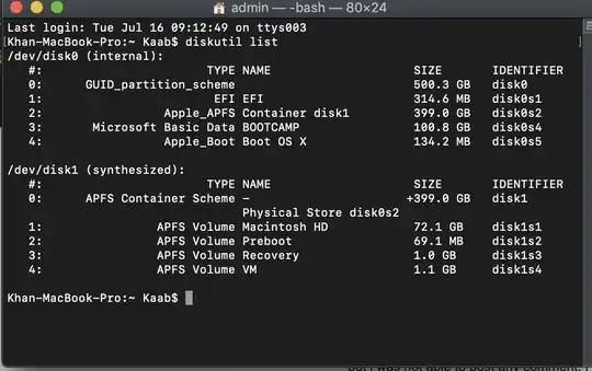

my MACMODEL diskutil list please see this, I want to start from disk partition. here is the result of the ''commands '' which you said in one of your ports. sir David ANderson

  • We can't see your screen, so you will need to help us in understanding what's going on. I assume you are following some instructions from a webpage, please add a link (or describe in detail the steps you've already taken). Also helpful is an output of diskutil list and similar. – nohillside Jul 16 '19 at 07:02

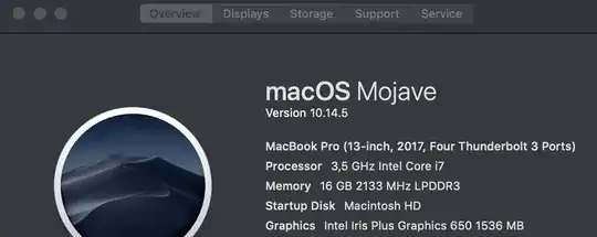

  • Khan, if you post a comment and include @David Anderson, then I will be notified. It would help if you could edit your question and add the model/year of your Mac and the output from the command diskutil list. Hopefully, you can be directed to an existing answer. Otherwise, maybe the hold could be lifted. Can you add a link to my answer that your are referring to? – David Anderson Jul 16 '19 at 07:18

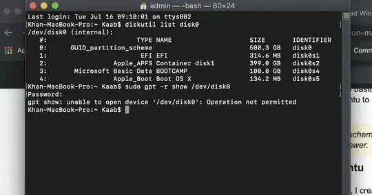

  • If you are using Mojave, then the instructions posted in my answer are not going to work. First, the gpt and fdisk commands will not work unless System Integrity Protection (SIP) is disabled. Second, your macOS partition is APFS so the diskutil resizevolume command will not work. Did you post the model/year of your Mac? – David Anderson Jul 16 '19 at 07:39

  • yes I have uploaded in the picture as well, its "MacBook Pro (13-inch, 2017, Four Thunderbolt 3 Ports)" – Khan Jul 16 '19 at 07:49
