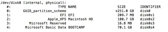

The output from diskutil list disk0 is given below.
/dev/disk0 (internal, physical):
#: TYPE NAME SIZE IDENTIFIER
0: GUID_partition_scheme *256.0 GB disk0
1: EFI EFI 209.7 MB disk0s1
2: Apple_HFS Macintosh HD 180.7 GB disk0s2
3: Microsoft Reserved 16.8 MB disk0s3
4: Microsoft Basic Data BOOTCAMP 70.1 GB disk0s4

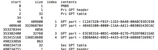

The output from sudo gpt -r show /dev/disk0 is given below.
start size index contents
0 1 PMBR
1 1 Pri GPT header
2 32 Pri GPT table
34 6
40 409600 1 GPT part - C12A7328-F81F-11D2-BA4B-00A0C93EC93B
409640 352968704 2 GPT part - 48465300-0000-11AA-AA11-00306543ECAC
353378344 4056
353382400 32768 3 GPT part - E3C9E316-0B5C-4DB8-817D-F92DF00215AE
353415168 136818688 4 GPT part - EBD0A0A2-B9E5-4433-87C0-68B6B72699C7
490233856 9766151
500000007 32 Sec GPT table
500000039 1 Sec GPT header

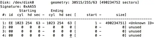

The output from sudo fdisk /dev/disk0 is given below.
Note: After repartitioning the drive, you should verify that the values shown below have not changed. Certain changes will cause Windows to view the drive as hybrid partitioned. If this occurs, Windows may fail to boot or malfunction.
Disk: /dev/disk0 geometry: 31123/255/63 [500000040 sectors]
Signature: 0xAA55
Starting Ending
#: id cyl hd sec - cyl hd sec [ start - size]
1: EE 1023 254 63 - 1023 254 63 [ 1 - 500000039] <Unknown ID>
2: 00 0 0 0 - 0 0 0 [ 0 - 0] unused
3: 00 0 0 0 - 0 0 0 [ 0 - 0] unused
4: 00 0 0 0 - 0 0 0 [ 0 - 0] unused
I decided to allow total of about 40 GB for Ubuntu. If you need a different size, then make the appropriate adjustments. I will be creating 3 new partitions for Ubuntu. A description for each is given below.

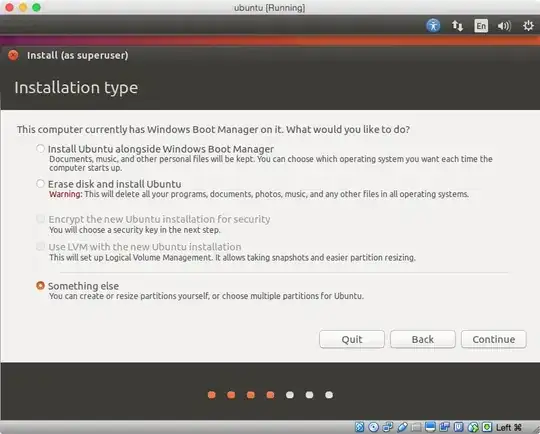

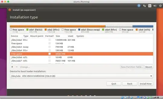

Insert the Ubuntu flash drive and restart the Mac. Hold down the option key to invoke the Startup Manager. Select to EFI boot from the USB flash drive. When prompted, choose the option shown below.
Note: For a better view, either click on the image or open the image in a new window.
Select language.
I choose to select both options below.
Choose the option shown below.

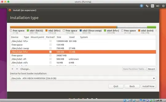

Select the partition shown below. This partition should be the same
size as previously specified for the Swap partition when the
diskutil resize volume command was entered.
Click on "Change..." and select "swap area" in the popup window as shown below. Do not change the partition size. Next, click on "OK".
Select the partition shown below. Next, click on the "-" to delete this partition.
Select the free space as shown below.
Click on the "+" to open a "Create partition" popup window. Select "EFI System Partition". Also, change the size to 500 MB and click on the "End of this space" button. Next, click on "OK".
Click on the "+" to open a "Create partition" popup window. Select "Ext4 journaling file system". Also, select "/" as the "Mount point". Do not change the partition size. Next, click on "OK".
Click on the "Install Now" button shown below.
Click on the "Continue" button shown below.
Select your desired location.

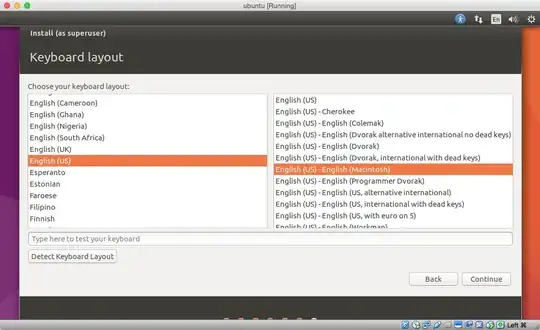

Select your keyboard.

Note: The 3 placeholder partitions have be replaced by the partitions specified while installing Ubuntu.
