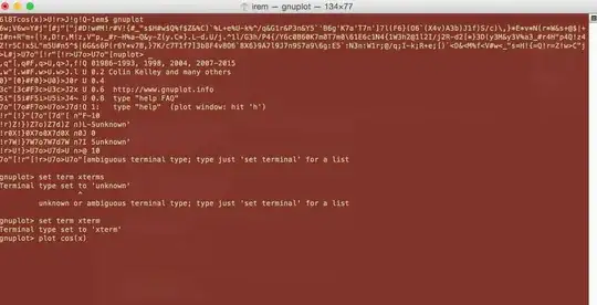

I installed gnuplot on my yosemite system using brew. When I try to plot cos(x) the way I would on ubuntu, I get this:
gnuplot> plot cos(x)
WARNING: Plotting with an 'unknown' terminal.
No output will be generated. Please select a terminal with 'set terminal'.
I also notice that when gnuplot loads, it says Terminal type set to 'unknown'. I would like to load the graphs in a new window, so I tried set terminal xterm, which seems to work at first glance, given the message Terminal type set to 'xterm'. But then I try plotting again, and it produces garbage:
How do I get the terminal to function correctly, as it does on ubuntu?

Don't know if you resolved, but seems strange to me you want to plot in the xterm terminal... Perhaps you want to display in the x11 terminal, you'll then find this discussion useful: Can't plot with gnuplot on my Mac

  • I am trying x11 but it says unknown or ambiguous terminal type; type just 'set terminal' for a list despite the fact that I have x11 installed on my system. – sodiumnitrate Apr 16 '15 at 14:08
    Ok, I followed the steps in the other post. Thanks for pointing out that I was confusing xterm with x11. – sodiumnitrate Apr 16 '15 at 14:27
