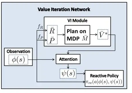

Architecture Value iteration networkVI Architecture reference Policy iteration architecture PI Architecture Reference

    @Scortchi-ReinstateMonica Yes, thanks. It looks like this answer is based on that tutorial. The initial table provided by the OP is really analogous to the one given in that tutorial. This answer is now more misleading than originally. In the last edit, the OP provided the diagram of "Value Iteration Network", which is not "value iteration". We may need to delete this answer to avoid spreading misinformation, although some info in this answer may be correct. More importantly, this does not even answer the question "when to use one over the other?". Not sure why it was accepted. – nbro Dec 29 '21 at 14:16
