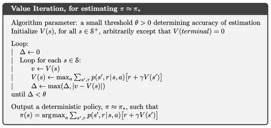

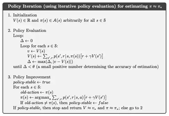

Let me first illustrate the pseudocode of both algorithms (taken from Barto and Sutton's book), which I suggest you get familiar with (but you are probably already familiar with them if you implemented both algorithms).
As you can see, policy iteration updates the policy multiple times, because it alternates a step of policy evaluation and a step of policy improvement, where a better policy is derived from the current best estimate of the value function.
On the other hand, value iteration updates the policy only once (at the end).
In both cases, the policies are derived from the value functions in the same way. So, if you obtain similar policies, you may think that they are necessarily derived from similar final value functions. However, in general, this may not the case, and this is actually the motivation for the existence of value iteration, i.e. you may derive an optimal policy from an non-optimal value function.

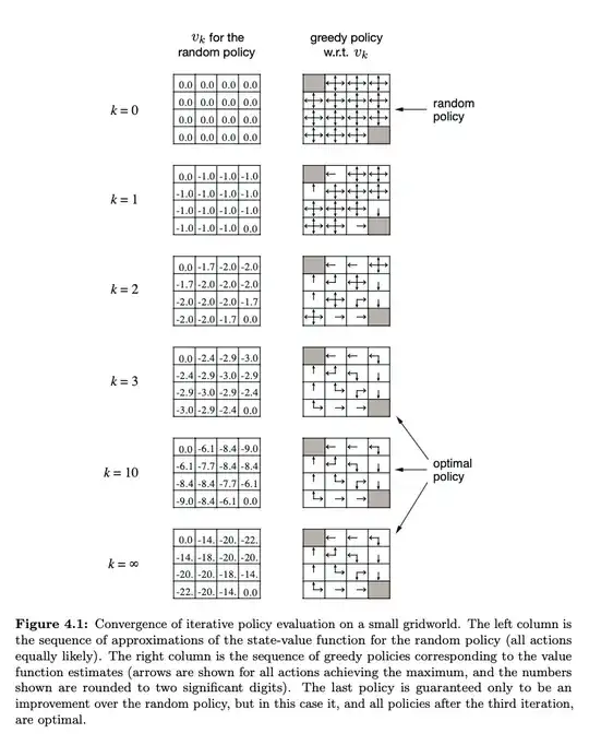

Barto and Sutton's book provide an example. See figure 4.1 on page 77 (p. 99 of the pdf). For completeness, here's a screenshot of the figure.
