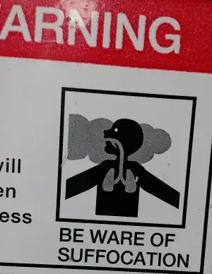

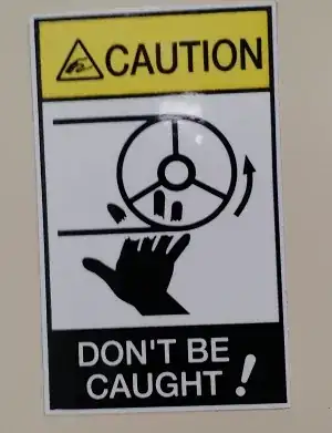

Yes, absolutely you can throw grammar rules out the window. Machine safety labels need to convey the danger clearly first and foremost. They also need to consider that the audience may not be fluent or conversant in the language at all. Grammar is largely irrelevant, and simple is always better.
As example, here are a collection of safety labels from some Japanese made equipment (installed in North America). I've not included the awkwardly translated text from some of them, and for many it's not even the grammar that's the worst part so much as the vocabulary itself. That said, strong iconography makes the point quite clear in all cases. The wording itself plays second fiddle, really.
machine safety label catch/pinch machine safety label suffocation machine safety label explosion machine safety label falling machine safety label heat/press machine safety label no standing machine safety label pinch/press
J...
  • 171
    you make two excellent points: consider the potential language barrier of the audience, and a good icon is worth a thousand words. – Lauren-Clear-Monica-Ipsum May 28 '16 at 18:25
    Ouch... the kerning... – Goodbye Stack Exchange May 31 '16 at 01:43
    @NeilFein PRESS is kerning... BE WARE is, I think, a deliberate whitespace lost in translation 0_o – J... May 31 '16 at 01:54
    Also note that, given the strong iconography, the Japanese decided that はさまれるな (Do Not Be Sandwiched) was sufficient for both the PRESS and ENTRAP warnings while their English counterparts felt deserving of unique words. A testament, I guess, to how particular English speakers are about finding exactly that correct phrase to fit the occasion. – J... Jun 01 '16 at 03:39
