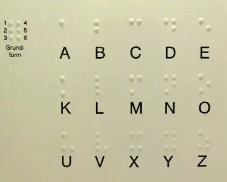

What software tools do publishers use to produce books for the blind, i.e. containing embossed Braille?
Is LaTeX one of them? There is a braille LaTeX package, which can be used to print Braille, but I'm not sure it can be used to emboss Braille. If not LaTex, what do publishers use?
I'd be keen to work on a LaTeX package for both printing and embossing Braille but, first, I need to know whether there would be an interest for such a solution...

    I would have assumed, that difference between printing and embossing is made by the hardware you use for the job. If the dot of the Braille syntax is reproduced as a toner/ink spot or an embossed point depends on the machine/printer. Or I get this question wrong. – John Smithers Feb 20 '14 at 23:28
  • @JohnSmithers I'm actually not sure myself. I was hoping someone here might be able to tell me more. – jub0bs Feb 20 '14 at 23:33
  • From the software side a spot is a spot. And if I get Braille correctly, then there is only one depth for a spot (not several embossing depths which carry different meaning). So Latex and the Braille package don't care at all. It only matters if you send the output to a printer or a embossing machine. But I have no idea how a embossing machine looks like or works. Google? – John Smithers Feb 20 '14 at 23:39
    A few years back I was teaching a math class with a blind student. Since I used LaTeX for producing tests I talked with the Accessibility Office at the college and found that their system for producing Braille for students required the test be retyped in a version of LaTeX, so they were thrilled that my stuff was already in LaTeX and they just had to do a little editing. So at least one school "published" materials in Braille using LaTeX. – mathnerde Feb 21 '14 at 18:19
