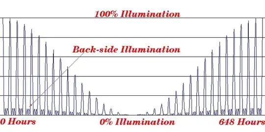

People would likely die from epilepsy (I'm kidding, but look at that graph!)
  • You now have a rogue world with an equatorial band of life-giving warmth and very large polar ice caps. Your "day" is 36 hours long. Your "great day" is 648 hours long. During most of that time you're going to see pulsating light to one degree or another. Here's a chart of how much light a person would see if they stood on one point along the equator for an entire great day:
Another way of looking at this is that it's "high noon" at one longitude only once every 648 hours. This is nothing more than the product of three sine waves: planetary rotation, lunar orbital period, and illumination cycle. It does not take into account refraction through an atmosphere (which would heighten the backside illumination pulses).

I forgot to explain what back-side illumination is: it's the illumination seen by that one point of longitude when the moon is illuminating the other side of the planet. This is because, starting with high-noon at our reference point, nin hours later the moon is on the other side of the planet at 50% illumination. Nine more hours and it's back over the reference with 0% illumination. Nine hours again and it's the backside with 50% illumination, etc. (This example assumes no rotation of the planet. The graph does.)

  • @JBH, how did you receive that graph? Due to "moon" phase taking less than moon orbital period, there shouldn't be intervals of time longer that said period when a person on the equator sees only "moon" state. Quite the reverse, there should be days, where he sees only "sun" and transitional states, i.e. "white nights". – A.C. Dec 03 '17 at 04:34
  • I edited my answer to include some math. It doesn't go into the question of distance as that requires knowing the diameter (and eventually mass) of the moon. Is that important? If not, don't worry about lunar distance. – JBH Dec 03 '17 at 05:32
  • @A.C., the OP says the illumination cycle requires two orbits of the moon. The planet rotates once for every 36 orbits of the moon. That's simply three sinewaves and a little math. You'll never see "days" of light and dark because the moon's orbit is 36X the rotational speed of the planet. (The only reason Earth sees them at the poles is due to the axial tilt of the earth). – JBH Dec 03 '17 at 05:34

  • @JBH I'm trying to recreate the graph to understand the daylight cycle better. Do you happen to have the formulas still around? (Expecially for the case of the backside illumination, the details of which are not 100% clear to me yet). – Francesco Manzali Dec 08 '17 at 22:56
  • @FrancescoManzali: This is a simple compounding of sine waves. Rotation = 1 + sine(PI/2+nPI/360); Pulse = 1 + sine(PI/2+nPI/5); Orbit = 1 + sine(PI/2+nPI/10); Illumination = (Rotation * Pulse * Orbit)/8; Where N = 0 to 721. I used Excel (PI function is pi()) to create discrete points and build the chart. Note that this is a simplification (e.g., no refraction), but it's reasonably accurate. – JBH Dec 08 '17 at 23:43
