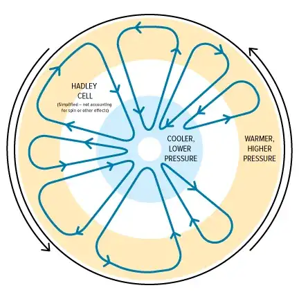

I've been considering this for a while (see my other cylinder hab-related questions) and this is what I've come up with so far:
On Earth the conditions are:
  1. Evapouration – atmospheric water vapour
  2. A thermal/pressure gradient – to carry and bring vapour together
  3. Condensation – atmospheric dust forms the nucleus of droplets
  4. Gravity – to draw the droplets to the surface
The first three three conditions would be present in an O'Neill or McKendree cylinder, but the nature of "gravity" in such an environment requires a substitute. That substitute is momentum, or wind, itself.
Aboard the habitat:
  1. Evapouration – Wind, heat and artificial light with the correct properties will evapourate water and keep it in vapour form just as on Earth.
  2. Given a sufficient thermal gradient hadley cells should form and carry moisture with them, from the warmer surface and higher air pressure to the cooler, lower-pressure central shaft: Diagram of hadley cells in a cylindrical atmosphere
  3. Condensation – dust is unavoidable. It may be necessary to periodically "seed" clouds by spraying particulates into the air.
  4. Winds will carry droplets through the atmosphere toward the central shaft, where they will collide with others and be carried through, back toward the surface. Unlike rain on Earth, this will "fall" in every conceivable angle, possibly looping and spiraling until finally connecting with a surface.

  • Something that factored into my thinking is: if the light and heat runs through he central shaft, shouldn't the center be warmer than the outer layers? That might kill this kind of heat engine. – ShadoCat Nov 30 '17 at 22:34
    Would Hadley cells work in that convex environment? On Earth they are aided by a convex Earth which helps to force rising air streams appart. But in a Cylinder that logic is turned on its head. – Slarty Dec 01 '17 at 00:20
  • @ShadoCat Heat transfers to the air by contact with the ground, producing thermal columns. If the air at the centre is thinner there's less of it to absorb and retain heat. – rek Dec 01 '17 at 02:12
  • @Slarty The diagram is overly simplified, but the principles of heat rises, cold descends should hold. Cells would probably spiral as they ascend and be less defined at the core. – rek Dec 01 '17 at 02:12
  • Yes true - I could see there being one giant spiral cell – Slarty Dec 01 '17 at 14:24
