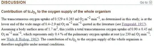

According to this paper, the human body can take up about 1mL of oxygen per minute, based on both their measured assessment and the theoretical model that required an algebraic static solution of Fick's second law. I've grabbed the relevant section since the article may be behind a paywall for some users:
Esentially, we're facing a difference of two orders of magnitude between what we need (8mg/sec) and what is possible to obtain (0.021mg/sec).
