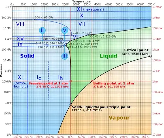

This planet has an ocean taking up roughly the same portion of surface area as the Earth's. How deep can it be? (The bottom must be liquid water) What else can be said about it?
