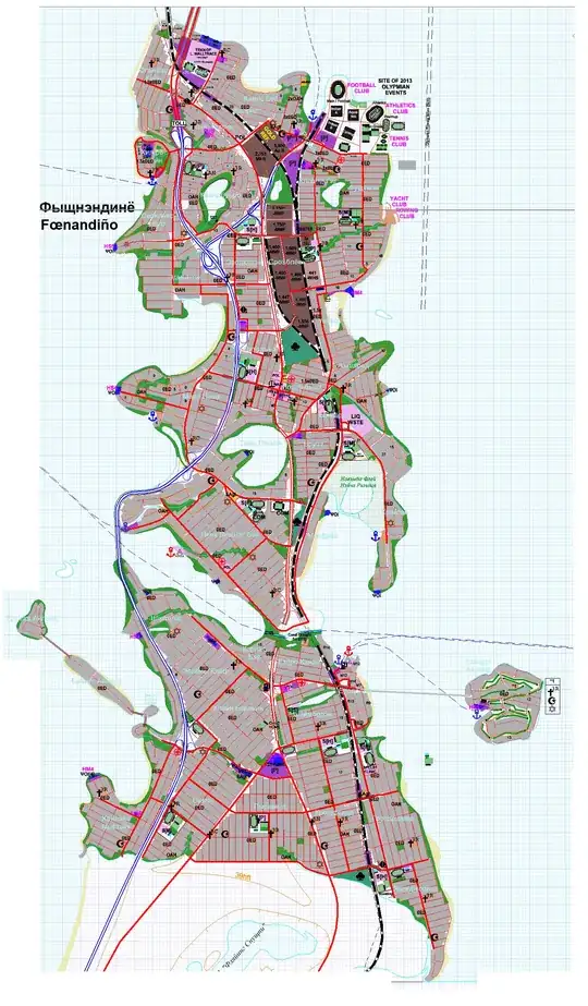

I have been drawing fictional maps for the last 20 years. I am currently busy on a project city that has an estimated population of 2,000,000. I agree with all the above posts. I used to do them by hand, but now I do them by CAD. My last few hand-drawn maps were done on some square paper; I pulled out a double A4 sheet (I'm in South Africa, and we use the metric system) and used the grid. Usually I draw on a scale of 1:20000. The map below I drew as a part of my project. Feel free to use it and/or comment on it. The scale of that map is 1:50,000. One small square has a side of 50m.
Anyway, here are my general steps:
  • Draw the coastline and/or your major river and/or lakes (the 'geographics')
  • Draw some contour lines (elevation) for your hills.
  • Lightly pencil in your major roads .A highway is on a gradient of 1:20, and so are my roads. Rail I design on a 1:100 gradient.
  • That will be your 'old' road; later feel free to design in a modern bypass.
  • If you choose to have an river flowing into a sea, then build a port in there. The size depends on your cities size. It could be a small marina, or a container depo.
  • Draw your waterfront. It should be about 50m wide, with small shops.
  • You should have a nice boulevard running next to your waterfront.
  • Draw your central business district (CBD) (offices), on the coast I use a 50m x 50m square per block. You'd need an office block per about 5000 residents.
  • Near your CBD, place a railway station.
  • Near that, I usually have a police station, municipal offices, the courthouse.
  • For cities larger than 50,000 to 100,000 the streets are usually one-way
  • Also in a larger city, have a feeder highway coming into the CBD
  • Place some dense residential buildings near your town center. a 30m x 60m plot can hold about 24 apartaments.
  • Residential areas need schools with sport fields. My model is that 17% of your population are school going children. My schools have a capacity of about 1000 students.
  • Don't neglect your religious facilities, your clinics and your cemeteries.
  • My suburbs are based on single family houses with the plot sizes varying between 400m2 to 2500m2 depending on the level of income.
  • Consider a small airport. Runway should be longer than 1000m by 30m wide, with about 100m on either side, and about 400m of overrun at each end, topography allowing. It should be on a flat terrain, but I have seen real-world runways on slopes. Usually the approach angle is 3.0 degrees to a runway (I held a pilots licence at one stage).
  • Spoil your residents with a stadium. Lots of parking around it.
  • Add a few factories. These have large footprint of about 200m x 300m. My estimate is that about 1/3 of your population works in the factories, and I assume 1 person per 100m2 of factory footprint.
  • Draw in the town bypass, maybe insert a small interchange. (Interchanges are one of my geeky passions)
  • Don't forget your parks (in Britain the ratio is roughly 1 plot of a park for 50 houses)
  • Railway lines have a minimum radius of 200m
  • Clover leaf loops are diameter 100m
  • Restaurants, bars, shopping centers. My town below doesn't have malls.
Here below is one I prepared earlier... 0ED = Kindergarden, OAH = Old Age Home, I have 5 different religions, the 'club' symbol on a green background is the cemetary, Green anchors are marinas, Red anchors are water based emergency services, blue anchors are ferries. Psi-Omicron-I (simulate a fork, plate and a knife) HS = Hotel Small. 1000 MMF = 1000 employees in a medium manufacturer.
This is what I'm currently busy with... Permission is granted to use the image
