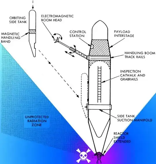

For a visual idea of the "shadow shield" I'm referring to, courtesy of Winchell Chung's "Atomic Rockets" site:
Shadow shield, from Atomic Rockets

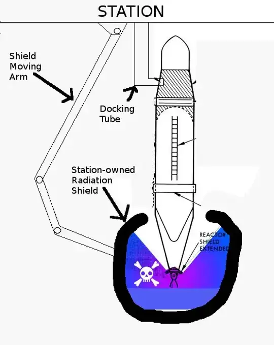

    Launches have a number of security and safety advantages. Only station-owned equipment and station-trained crew are ever used for station docking, questionable cargo can go through customs before it enters the station, nuclear material can be stored off-station, and it's much easier to enforce efficient quarantine procedures to prevent biological contamination issues. – Tobias Hagge Jul 15 '17 at 04:00

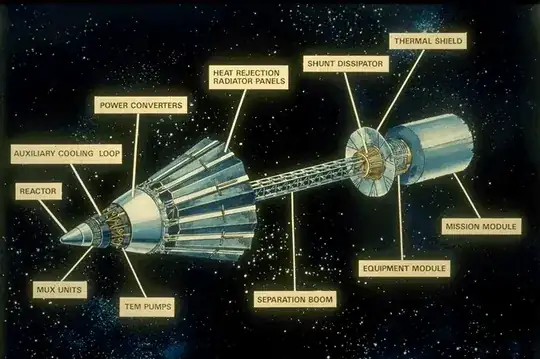

Shielding already is direction; shadow shields are fine
You only need shields on the sides of the ship that are in danger of irradiating someone. For example, on nuclear aircraft carriers, there is no shielding (of the lead/poly/water type, there is still structural steel) on the bottom of the reactor, because no one cares if neutrons go that direction. There are no potable water or fuel tanks below the reactor, so the only thing in that direction are ballast tanks and the ocean. In the specific case of ships (and submarines) there is no concern that fish will get irradiated because the water is an excellent neutron shield, and a reasonably good gamma shield. In space, there are no fish and everything is very far away, so released radiation is generally harmless.
You could have a space-ship that is only shielded in one direction. If you imagine a ship with a reactor that is an $x$ meter radius sphere; then an $x$ meter radius shield provides a 90 degree arc of radiation protection. The reactor can be installed in the back of the ship with the reactor immediately forward of it. The rest of the ship forward of the shield is thus completely shielded. I am terrible at drawing so imagine the following picture.
What is labeled as mission module would be the reactor (and propulsion unit). What is labeled as the thermal shield would be a radiation shield (and also a thermal shield, incidentally). A good bit of separation, and then you put all the important things like people and cargo-you-don't-want-irradiated in the front.
This design drops the shielding area by a factor of 4 (the surface area of a sphere is $4\pi r^2$ vs $\pi r^2$ for a circle of the same radius) and saves you mass.
