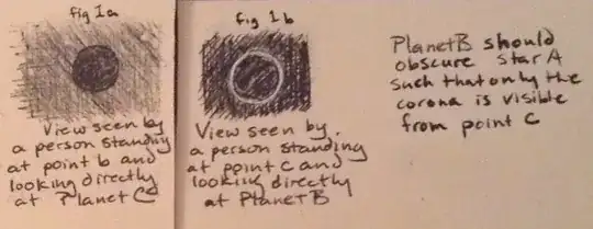

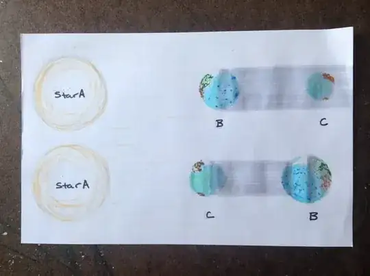

Here are the shadows I'm trying to achieve:
Figure 1: The two possible shadows cast by each planet
when all three bodies are in alignment

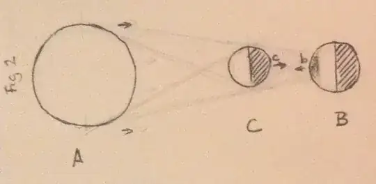

I'm going to leave my inaccurate drawings above for now because they better illustrate the landmasses and ocean areas on both planets. I'll replace them when I'm able. More accurate yet simpler sketches below along with (hopefully) improved wording.

During A-B-C alignment (Fig 1)
- A being floating in the center of the night side (it's in the middle of the ocean) of Planet B (point b) will see only a circle of darkness blocking the stars (behind Planet C) when looking toward Planet C. (Fig 1a) Planet C should fall well within the umbra cast by Planet B.
- A being standing at point c will see a total eclipse of Star A by Planet B when looking starward. Only the corona should be visible (Fig 1b)During A-C-B alignment, (Fig2)
- A being standing in the center of the night side of Planet C (point c) will see Planet B as a thin blue ring – with an apparent width not wider than 1/6 the radius of Planet B – with northern polar ice visible. More temperate landmass may be visible closer to the northern side of the equator.(Fig 2a)
- A being standing at point b will see an annular eclipse of Star A by Planet C because Planet C is not large enough to eclipse it totally (Fig 2b)
