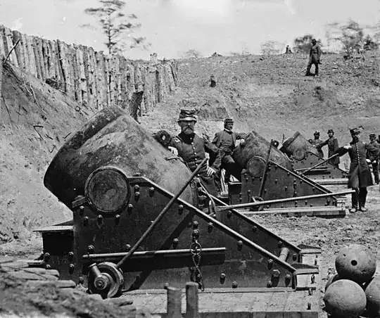

2A mortar might be easier to manufacture than a "real" cannon - given that it is a thick-walled, short-barrelled gun. Technically still a cannon though. – Ghanima May 07 '17 at 20:14

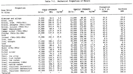

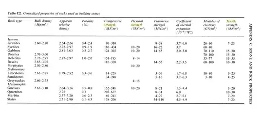

In reading for this answer I was interested to see that a comparison of cannon metal strengths was published in the New York Times in 1861. This sort of thing was apparently considered to be of general interest. Which is very cool, and maybe a little sad - not for them, but for us.
There are several different qualities which comprise the strength of a material. Different qualities are important for different uses. An important characteristic for a cannon barrel is tensile strength. Tensile strength is the ability of a material to resist being pulled apart. Tensile strength for a material is often presented with compressive strength which is the ability of a material to resist being crushed together. Stone has excellent compressive strength which is why you can make buildings out of big stacks of it. Stone has weak tensile strength - inferior even to wood - which is why we never see stone in applications relying on tensile strength. In the tables below you will see that metals (except lead!) have tensile strength an order of magnitude greater than stones.
(Below screenshot from http://www.arcraftplasma.com/welding/weldingdata/metalchar.htm)
(Below screenshot from Stone: Building Stone, Rock Fill and Armourstone in Construction)
The units for strength are actually the same: $$1\ meganewton/m^2\ (MN/m^2)\ =\ 1\ megapascal\ (MPa)$$

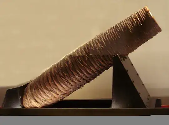

Wikipedia has an entry on wooden cannons. I am loving this rope wrapped one. I have never read anything about burying the cannon or using packed earth with a nonmetal cannon.

4Props for the rope-wound wooden cannon. Even more interesting is that Basalt fibers are a real, usefully strong, commercially available thing. See https://en.wikipedia.org/wiki/Basalt_fiber and http://basalt-fiber.com/ So, one could easily imagine using basalt fibers, in some suitable matrix, to make a cannon barrel out of stone. – Catalyst May 07 '17 at 17:55

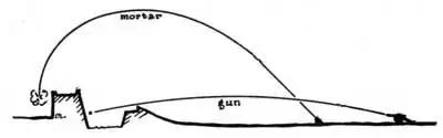

The low velocity means if you want it to get very far you have to fire at a high angle. So you'll have some sort of stone howitzer or mortar firing an explosive shell.

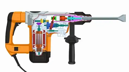

The tool shown here is a hammer drill, it works by providing a great impulsive force through hard vibrations that will tear through stone or concrete with ease, however, this tool would never in a million years tear through iron or steel.
In summary, a stone cannon would look great and it would work for a few shots, but once the pieces start chipping away, it is going to fall apart.
