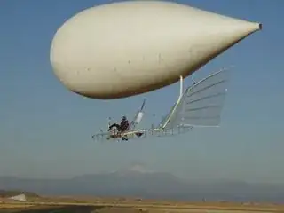

However, there has been at least one pedal-powered airship!
Make that at least two ... the White Dwarf, built in 1984
piloted by Bryan Allen, famous for flying the Gossamer Albatross across the Channel in 1979. I believe White Dwarf still has the world record flight (58 miles) for pedal powered airships, and cruises at 6 or 7 knots.
and a French one, on which Stephane Rousson apparently failed to cross the Channel in 2008.
It's not totally beyond belief that one could be built using 18th century materials - very light woodwork or bamboo, silk, and hydrogen gas - though performance might be less than modern standards.

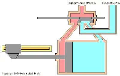

I think the answer is: using 1920-1930 aerodynamics and flight mechanics knowledges, late 18th century steam engines knowledges, wood and fabric.
Remember Clement Ader's 1890 steam engine produced 20hp for 51kg, which is 2.5kg/hp, while Wright brothers 1903 internal combustion engine produced 12hp for 75kg, which is 6.2kg/hp.
An 18th century Watt's double action piston steam engine, made out of steel, could have produced enough power. Even if it was 20hp for 150kg (7.5kg/hp)
Put such an engine on (let's say) a 1930 Piper Cub, or a Fiesler Storch, and it will fly. A Piper Cub is mostly made of wood and fabric, which was doable in the 18th century.
Main problem was the lack of knowledges in aerodynamics, but if guys like Otto Lilienthal, Wright brothers and Gerhard Fieseler were born in 1750, and met an other steam engine genius, then first human heavier than air flight could have been achieved in late 18th century.
5But that 1890 steam engine required 1890s technology for high-grade steel and precision machining. It would have been utterly impossible to construct that a century earlier, because that quality of metal and machining did not exist, and could never have existed because it built on continuous advances over that century. The state of the art for lightweight steam engines by the end of the 18th century was the kind of engine that went into Puffing Billy. So even if you had the aeronautical knowledge, you still wouldn't have a viable engine. – Graham Apr 24 '17 at 12:51
7Not to put too fine a point on it, it's not just Lilienthal and Newcomen getting together. You also need Bessemer, Mushet and all the engineers who developed tool steel production, and spent decades investigating the properties of various alloys. And then you need the myriad nameless engineers who invented proper metalworking lathes, drill presses and so on over the 19th century, and you need the precision measurement techniques required (and enabled) to go along with it. – Graham Apr 24 '17 at 13:08
@Graham Nice input I agree, precision machining and tools to do so would have been essential, at this time. But if you think "takeoff and land" or 3 minutes operation time, some leather sealed piston could survive. – Apr 24 '17 at 13:32
3Don't forget what you need to run the engine. The mass of high-end steam engines wasn't the only problem - you also need to account for the water. You'd need a closed-cycle steam engine for any duration flight, and those are a lot less mass-efficient than open-cycle engines. – Luaan Apr 24 '17 at 14:06
