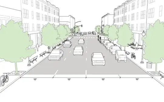

For example, a street this wide to have enough blood run down the length shown in this photo? Assume that the blood isn't going down storm-drains for whatever reason and assume the stretch of road is 100 feet long. There need not be literal 'rivers' of blood, just enough that the entire street is coated enough to obscure the road beneath. The bodies the blood comes from can be included in the answer.

Width - Pretty simple, 12$\times$4=48 so 48' (~15m for anyone not familiar with imperial.)
Length - Apparently it is a 100' (30.5m) long road.

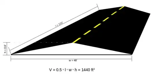

Appendix
A diagram drawn up by @MadPhysicist may help clear up the first method. I used a slightly different method by using half of the height instead of putting a half in the whole sum but other than that the methods are the same.
Diagram of road
Summary Table
$$\begin{array}{|c|c|c|} \hline \text{Method name} & \text{Minimum} & \text{Maximum}\\ \hline \text{River method (no bodies)} & 7475 & 29000\\ \hline \text{River method (corpses)} & 7128 & 28500\\ \hline \text{River method (ground bodies)} & 690 & 690\\ \hline \text{River method (dilute)} & 2376 & 9500\\ \hline \text{Painting method} & 8 & 32\\ \hline \end{array}$$ Disclaimer - My maths is probably wrong. Please point out my mistakes.
